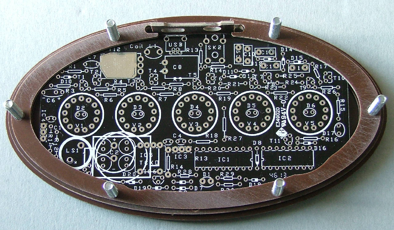

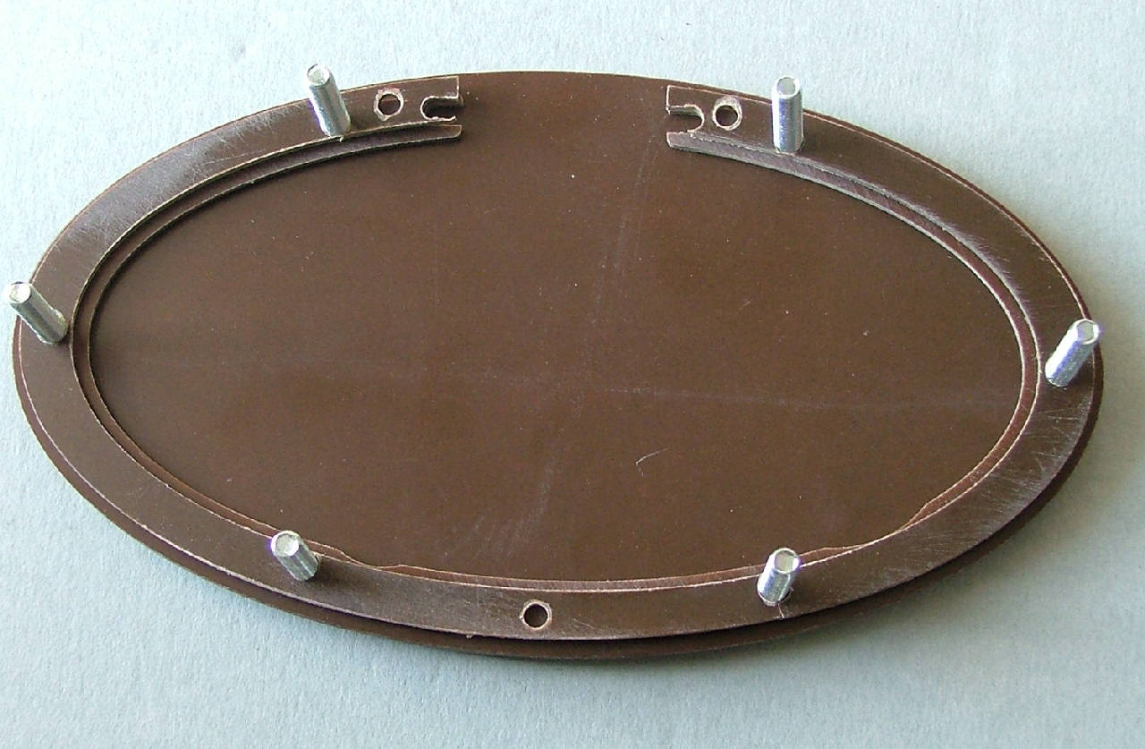

Unpack the case piece bag and seperate the laminate parts for sanding. Spending some time here wet sanding with fine emery paper will give a *much* smoother rounded finish and if you're really patient the bakelite top can be polished to a gloss finish with a fine polishing paste such as car paint restorer. If you bought the brass or zinc version the metal parts will need filing and sanding to clean them up before polishing.
Carefully sand the case top and bottom making sure not to scratch them, the side rings will be hidden so scratches aren't so much of a problem but they are fragile so don't put too much pressure on them.
