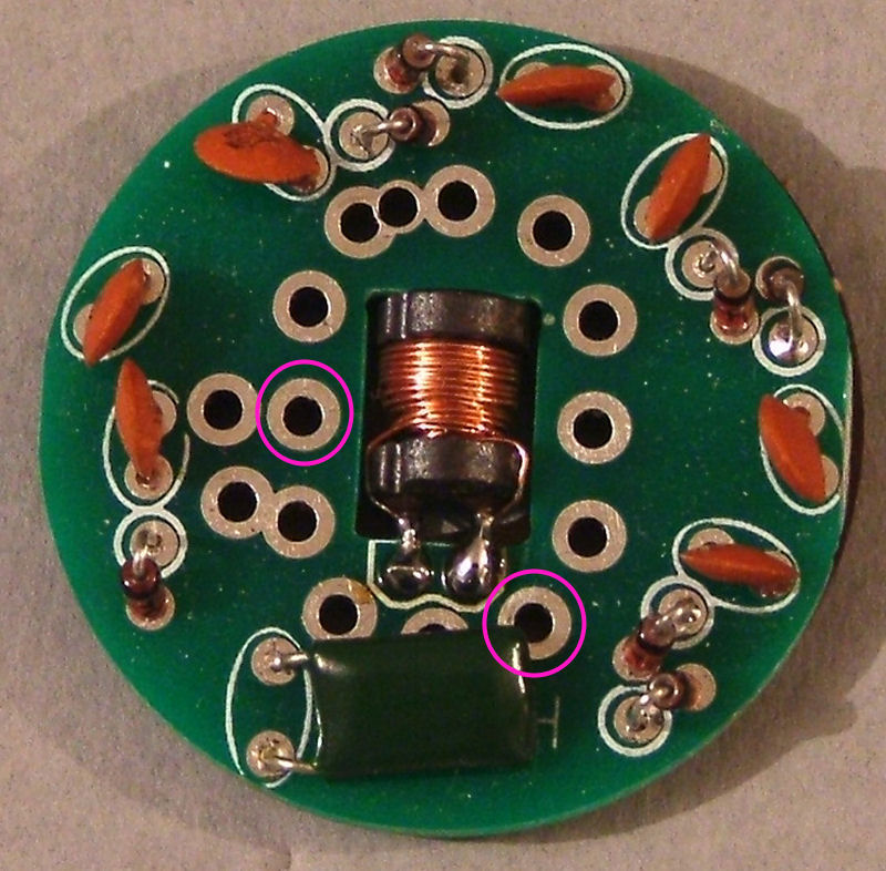

Fit two pins as shown and solder in place.
Make sixteen of these for use with 16x IN-15As: Pawn (Minion)
Make four of these for use with 4x IN-15As: Tower

Plug a suitable nixie tube for the board into the two pins, the anode can be identified by the white ceramic coating on the inside of the tube.
This connects to the 'HV' pin. It's now ready to test and once confirmed working can be fitted inside a piece base case.
