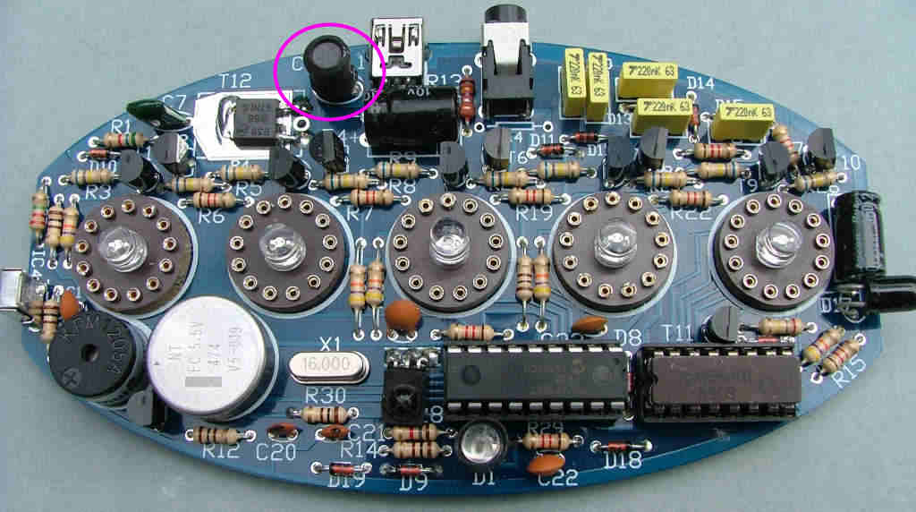

Nearly time for another power test: Fit the 20nH coil (copper wire spool) into the position marked Coil L1.
Re: PCB assembly - Nixies
This is probably a good time to mention from this point, DO NOT TOUCH the board whilst powered and allow 30-60 seconds after switching off before handling it, it's now generating 180V+. It's at a low current it will still bite and could be dangerous in the wrong circumstances (Note the wrong circumstances are probably when you'll touch it).
Connect the mA meter again to the space marked for R13. Connect the USB power supply and switch on, watching the meter. This time if everything is working the current should be between 250-300mA and the blue LEDs and nixies will light up - if not switch off quickly and recheck everything, mostly around T12,C6 and the resistors/transistors behind the nixies.
If everything went OK you should now have a display similar to 00+00 with flashing decimal points and a colon cycling between + and -. Now finally fit the fusible 0.47R resistor in place of R13 and let it run for a while.
