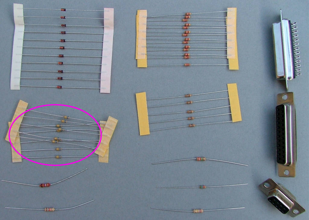

After preparing a suitable working space take the PCB and the 10x 680K resistors (blue-grey-yellow) or 2m2 (red red green). Fit these in locations marked for R24,25,26,27,28,29,30,31,32 and 34 as shown:

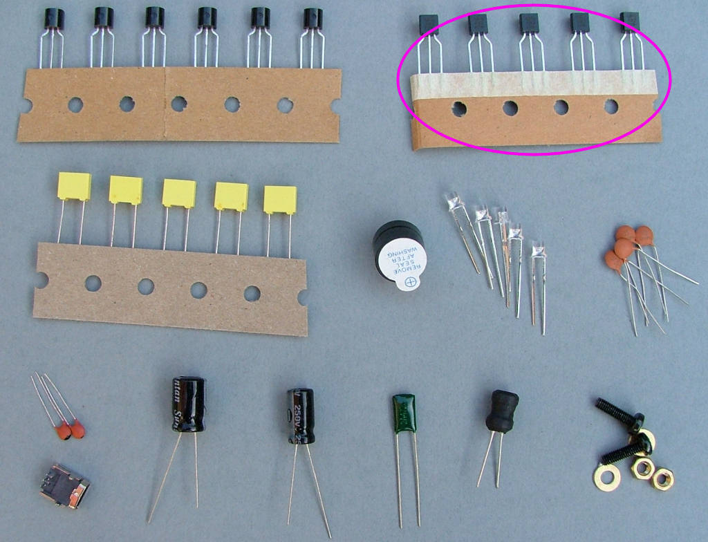

Fit 5 of the black plastic transistors marked 'MPSA42' or 'KSP42' in locations marked for T1,3,5,7 and 9 as shown: NOTE these are polarised and must be fitted the right way round. There is a flat mark on one side of the body, this flat side faces to the LEFT of the PCB when viewed as shown in the photograph.
Fit the black plastic transistors x5 marked 'MPSA92', 'A92', 'KSP92' in locations marked for T2,4,6,8 and 10 as shown: NOTE these are polarised and must be fitted the right way round. There is a flat mark on one side of the body, this flat side faces to the RIGHT of the PCB when viewed as shown in the photograph.

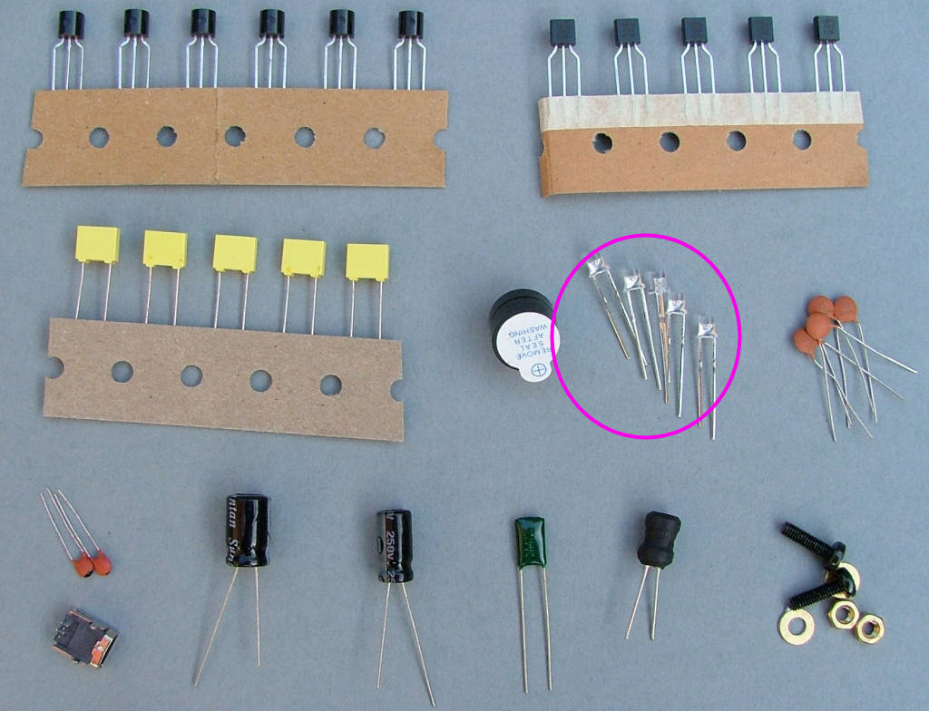

Now a tricky one: The 3mm blue backlight LEDs are fitted from behind the PCB through the holes under each nixie but with the wires running through to the top and are soldered from above. Bend the wires 180 degrees so the point up with the SHORT wire on the top left and the LONG wire on the top right when fitted through the PCB. These go in the places marked for LED 1,2,3,4 and 5.

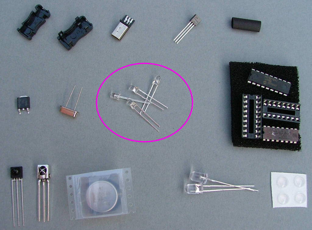

Next are the 4 amber decimal point LEDs. These originally used neons but I found LEDs to be more stable. You'll find them in bag 2 to prevent them being mixed up with the blue LEDs. If you received two 5mm IR LEDs, the amber LEDs will be water clear as in the pictures. If you received two 3mm IR LEDs, the amber LEDs have shorter wires. These again are polarised and the SHORT wire faces to the LEFT.

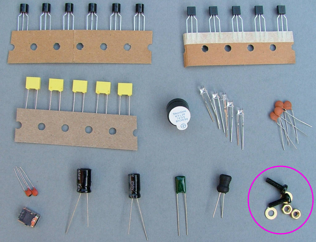

Solder the brass 3mm nuts to the PCB at each end, these hold the end caps in place when the case is assembled. Clean the brass and tin them first, they must have a good hold on the PCB.
