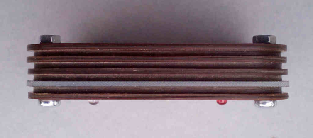

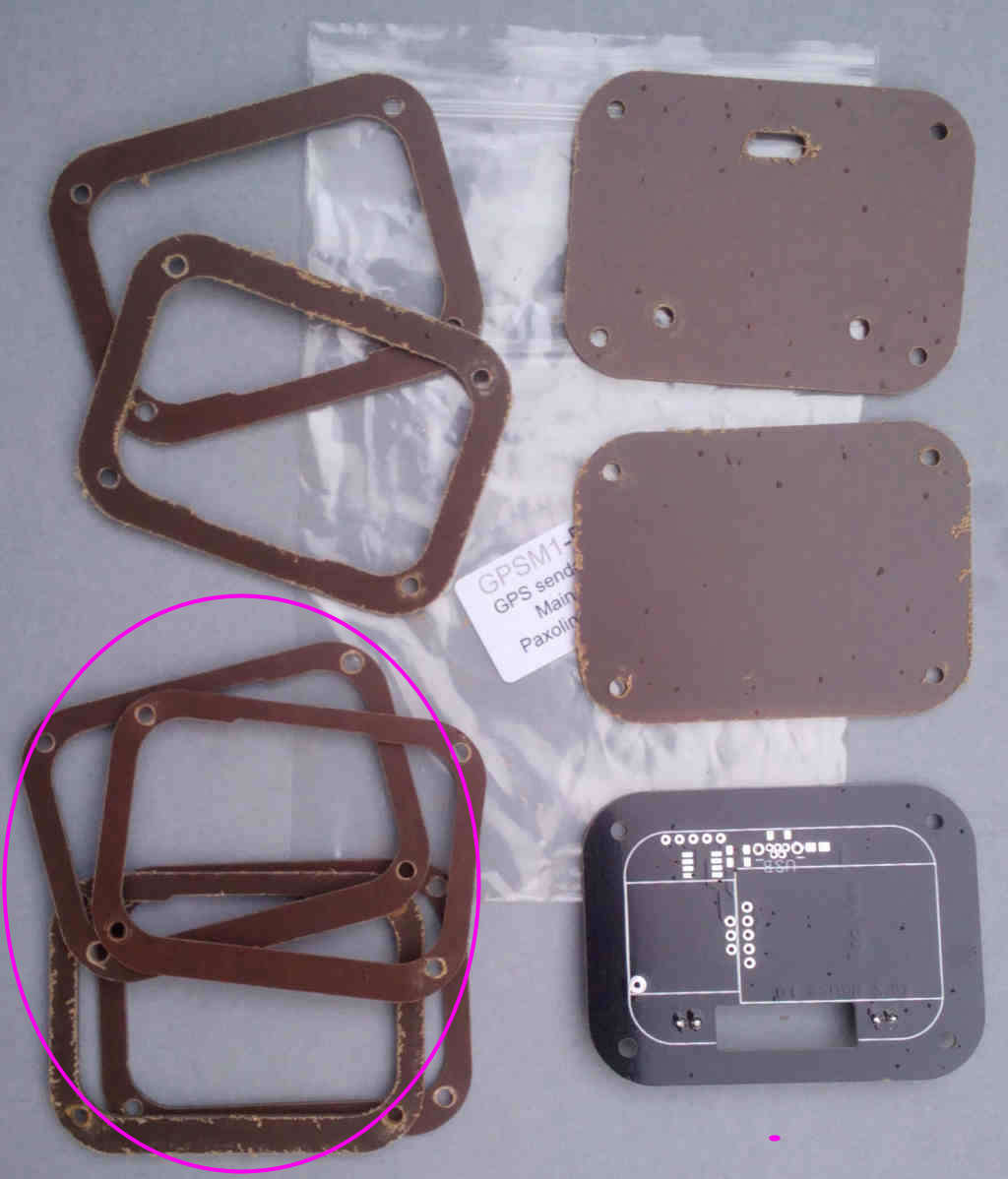

Once you've finished testing the receiver works it can be built into its case. This is a simple stack of laminate rings held together by 4 M3 bolts, they'll need to be sanded before use.

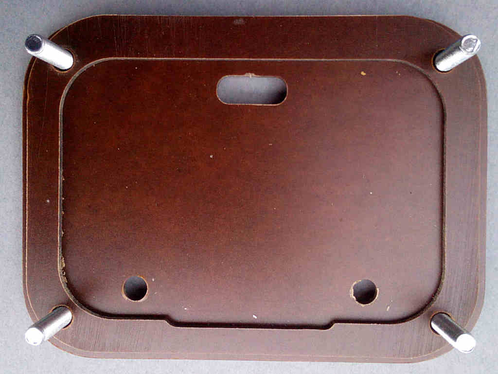

Start with the case back - the piece drilled for the socket and LEDs:
Push the 4 bolts through the corner holes - don't use washers - and turn upright:
