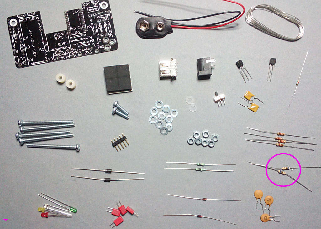

After preparing a suitable working space take the PCB and the 4x 1k2 resistors (Brown red red). Fit these in the locations marked for R3,4,6 and R8:
