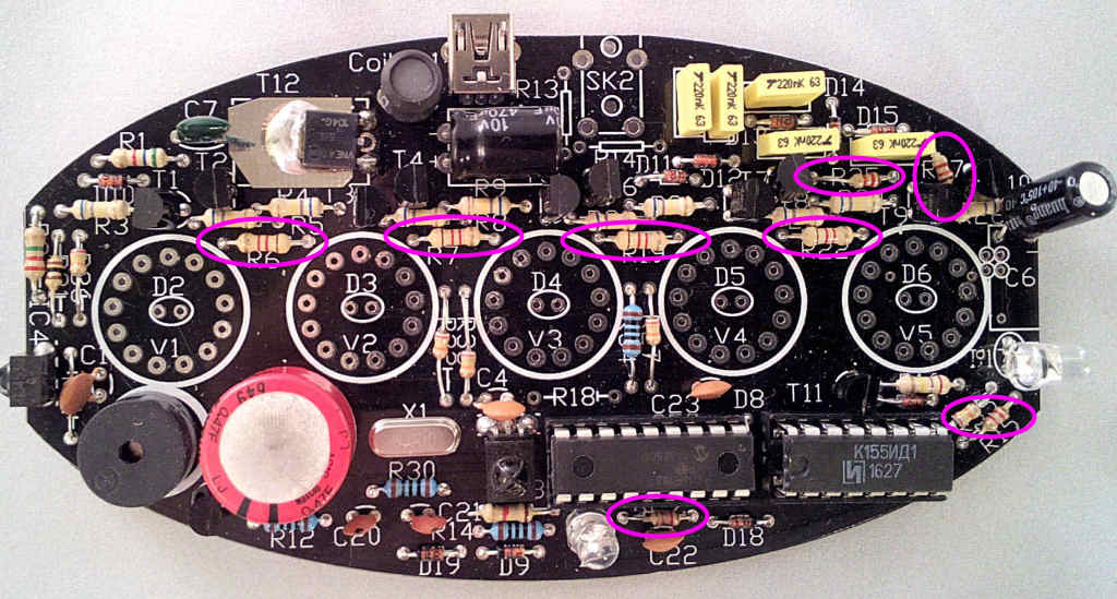

Fit the 9x 1K or 1K2 resistors (brown black red) or (brown-red-red) in locations marked for R6,7,15,17,18,19,22,25 and 29 as shown (note R18 is fitted though not shown here):

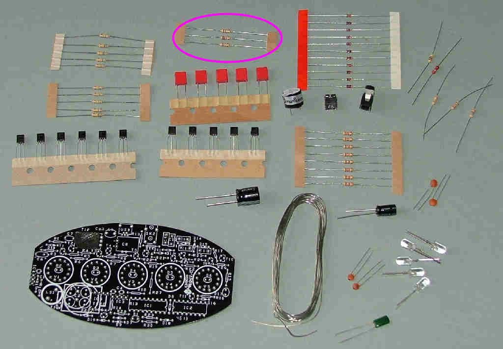

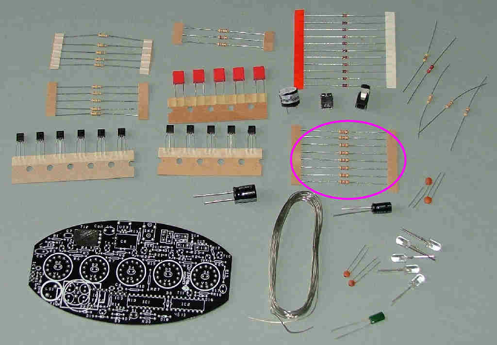

Fit the 5x 100r resistors (brown-black-brown or brown-black-black-black) or 5x 91r resistors (white brown black) in locations marked for R11,12,14,31 and 30 as shown:
Re: PCB Assembly - Bag1

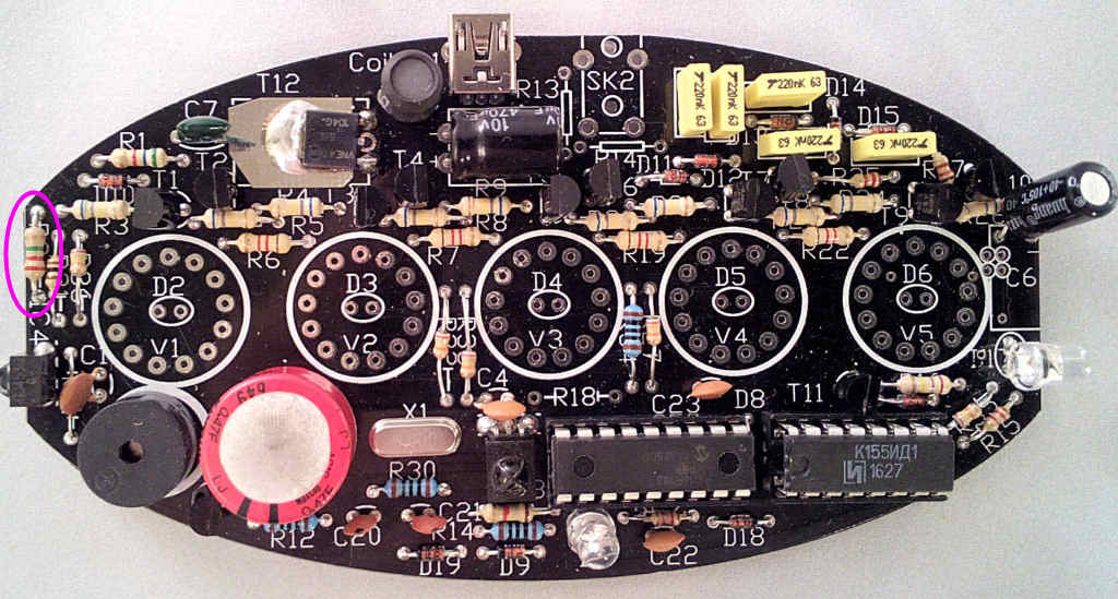

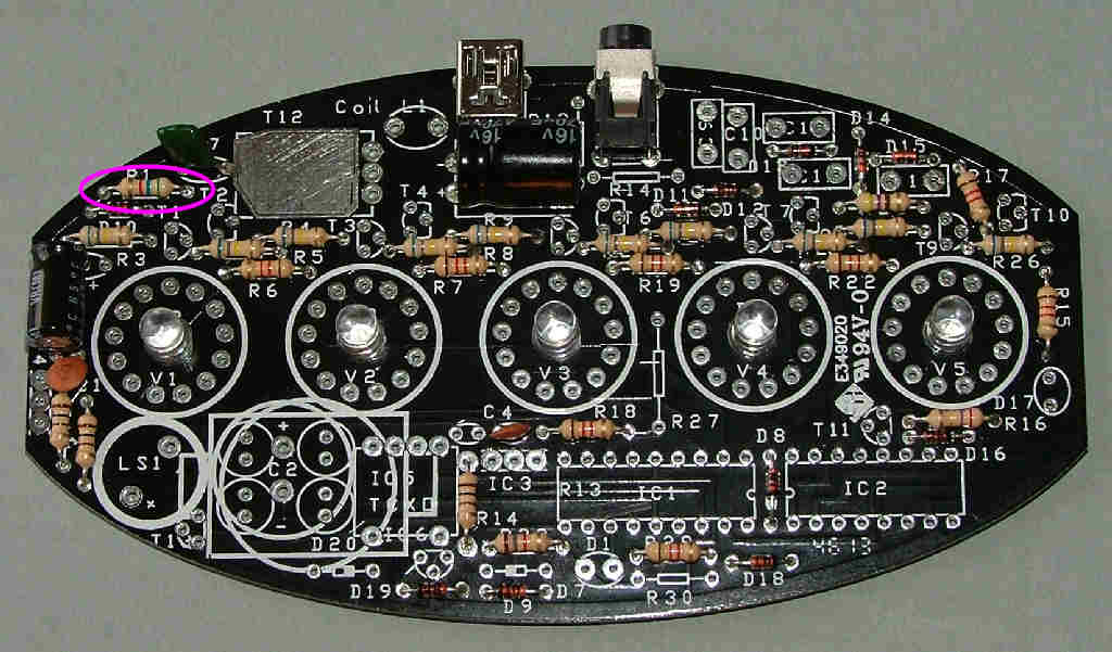

Fit the 5K6 resistor (green-blue-red) in the location marked for R1 as shown:

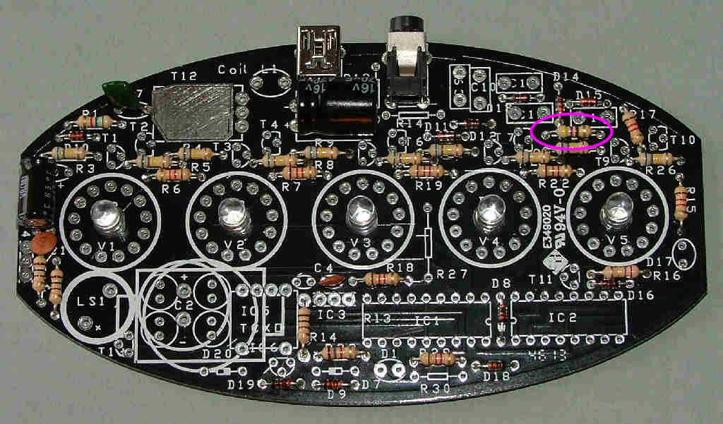

Fit the 470r resistor (yellow-purple-brown) in the location marked for R25 as shown:

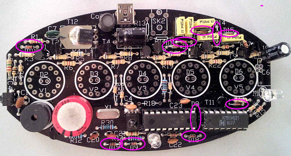

Fit the 1k8 resistor (brown-grey-red) in the location marked for R28 as shown:

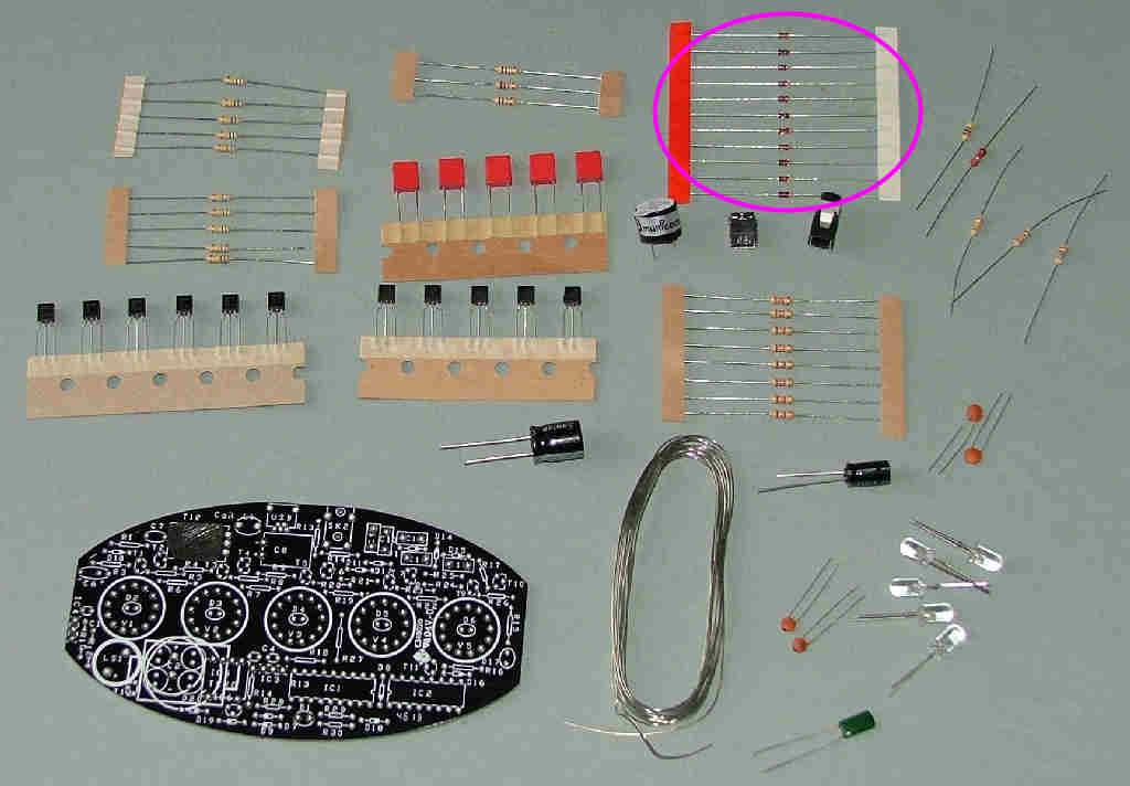

Fit the 11x 1N4148 diodes in locations marked for D8,9,10,11,12,13,14,15,16,18,19 as shown: **NOTE** the band marked on the end of the diode body must face the same way as shown in the photograph, this is also indicated on the PCB with a thick white band.

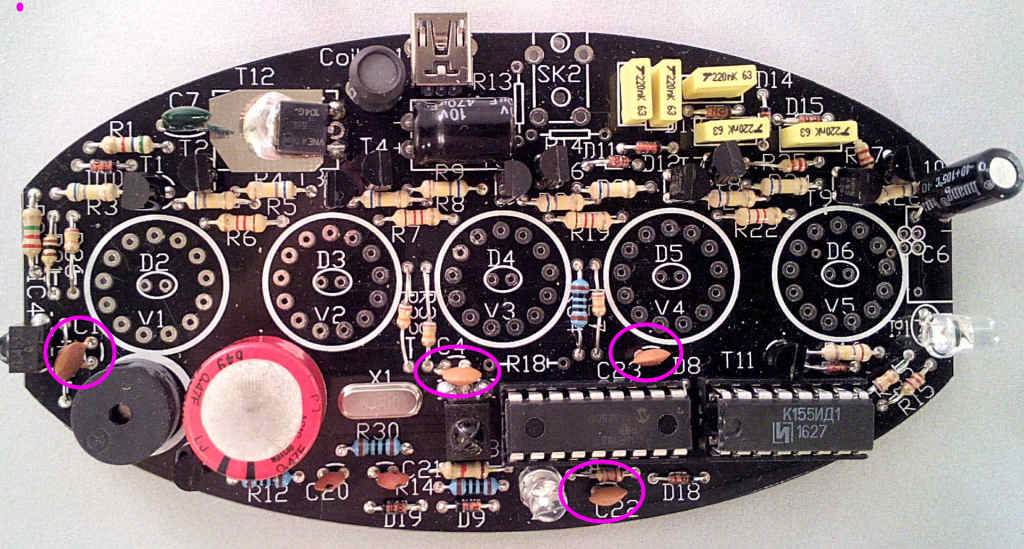

Fit the brown 10n (marked 103) or 33n (marked 333) ceramic capacitors x3 in locations marked for C1,4 and 22 as shown - DO NOT fit one in C23 as in the picture - please ignore that component.

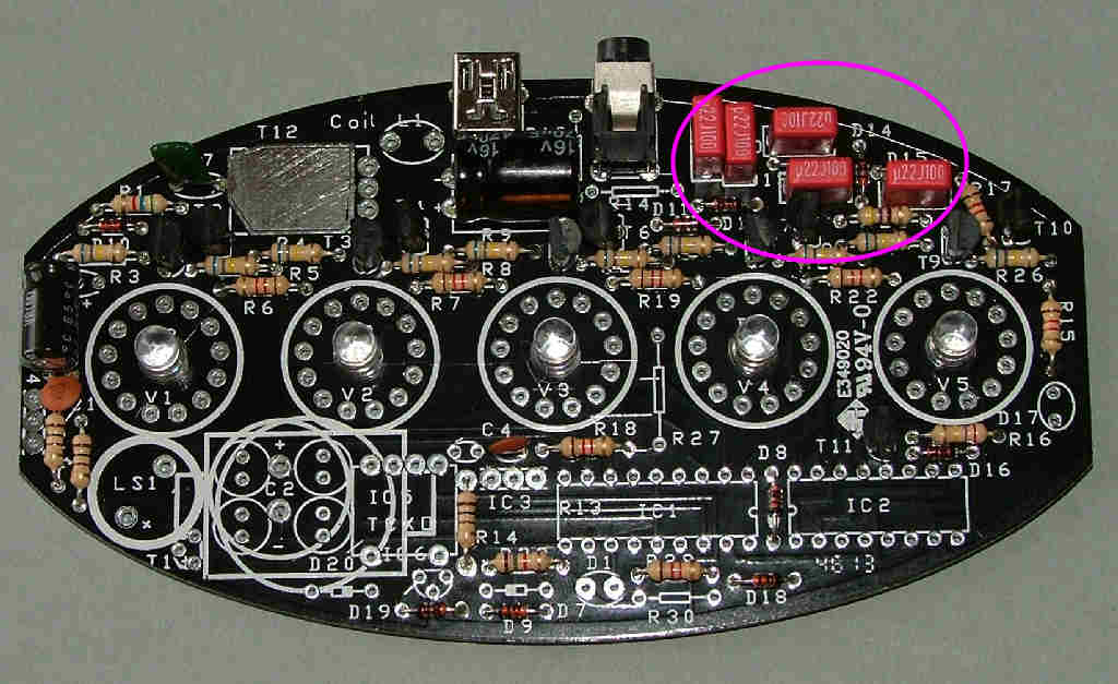

Fit the red or yellow plastic .22u capacitors x5 in locations marked for C9,10,11,12 and 13 as shown:
